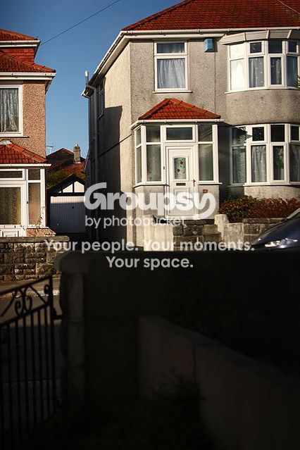

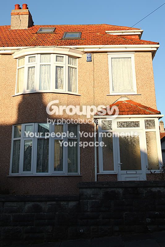

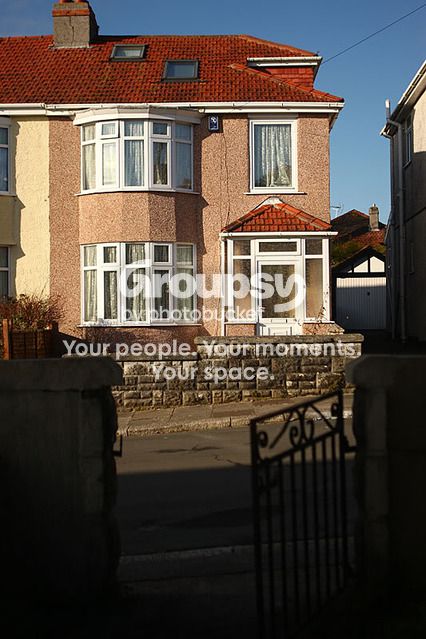

One of the main uses for the SHIFT function in a lens is to correct for converging verticals in architectural images, but it can also be used artistically to create more diverging verticals.
This is an uncorrected image of diverging verticals:
This is a corrected image using the SHIFT function of a lens/adapter (could have used a little more SHIFT but then I would have cut the chimney pots off and I couldn't go back any further).
This is an image with the diverging verticals enhanced by the use of the opposite SHIFT to the corrected image and could be used for artistic purposes:

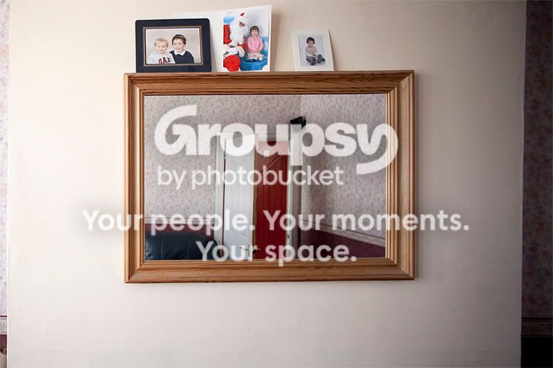

SHIFT to give clear sight of a mirror or glass area.
The SHIFT function can also be used to ensure that the photographer's image is not seen in photographs of mirrors or glass which would be to the detriment of the image being created. Paticularly useful when photographing Shopfront windows.
