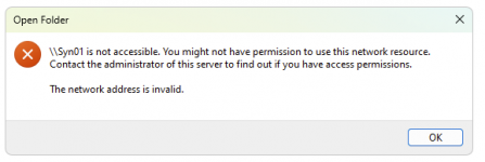

When I try to access my NAS through explorer this is what I get. It's same result if I use Back4all. I can connect through Synology assistant and set things up, not a problem.
I've tried a few Googled method with no result so any help would be appreciated.
NAS Synology DS220j
Edition Windows 11 Home
Version 23H2
Installed on ‎11/‎01/‎2024
OS build 22631.4037
Experience Windows Feature Experience Pack 1000.22700.1027.0

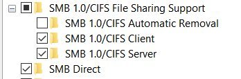

Also go to windows features and make sure it looks like this
It is also possible that a windows update has changed the above, which would probably stop NAS access if it is an old NAS, or using the old protocol
You definitely do NOT need SMB1 to access a Synology NAS, in fact you should avoid SMB 1 completely unless you have a VERY specific reason to enable it. SMB1 is highly insecure. It has many exploits/vulnerabilities .
That depends on the age of the NAS, my Synology only supports SMB1, nothing more recent, so I DO have to use SMB1.
Obviously I do not have any of the functionality which opens it to access outside of my LAN enabled.
The OP said the nas is a year 2020 model, so it definitely does not need SMB1, mine is a 2018 year model and it defaults to SMB2 and Large MTU as the minimum standard.
Yes, more recent models do indeed support SBM2, and you should use that if available - but that does not mean that EVERY Synology NAS can do so - there are still older models working happily, for which SMB2 support was never added.
I'd agree with the recommendation to try using the IP address to try and narrow down the problem, the error suggests it can't resolve the name syn01 for some reason.
just looking at the origonal image
the network address is invalid
are you sure your IP address is correct?
do a ping and check the NAS to double check the IP
