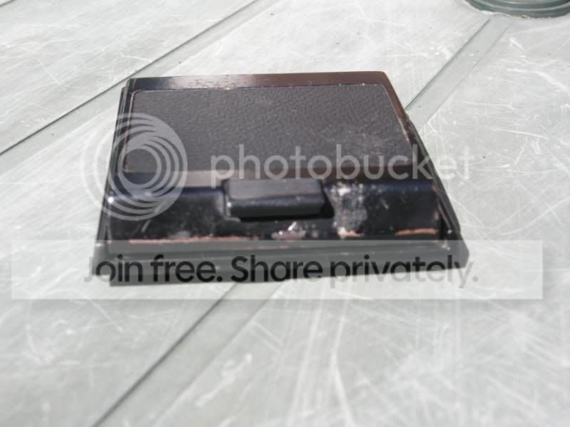

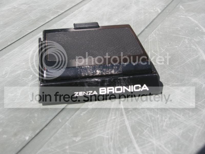

I've got a WLF but it's a bit worse for wear
Cool, I'll be in touch when the camera arrives, I really hope it sneaks itself through customs without being noticed.
