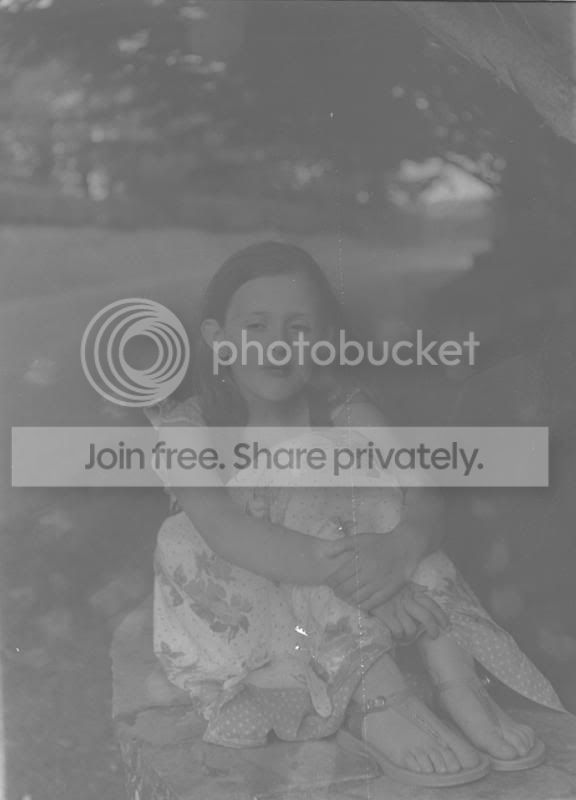

grey and dark or light but no real range to them I'm gonna try and get this sodding scanner to work in windows 7 to show you pics
this is a pretty good print from the sesh there are drying marks on it pos from the neg as opposed to the print and a line, but my problem is the lack of contrast and the softness and just generally looking crap :confused: seems both too dark and too light :confused:
help me wise ones
What a shame - that's a really nice shot. Thankfully digital technology can do a pretty good job of rescuing it, although you'd need a better scan to do it justice.
It doesn't solve the problem of what went wrong though, although it's easy to assume it's either under-exposure and/or under-development, which is what it looks like.

What does the neg look like? An old rule of thumb is that if you lay the neg emulsion side down on a sheet of newsprint, you should just be able to read the print through the darkest part of the negative.

I can just read the back of a pack of paracetamol through the darkest part of the neg so thats about right (I followed those times as I had proper instructions there - was v straightforward)

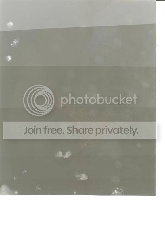

did you keep the test strip? Perhaps you could scan that and we could see what happened there.

sure I'll grab the strip and photobucket it
it was just a guess because I was ****ed off at not getting prints so wanted a ball park figure to start from
I'll mention that this strip was done with a different enlarger on an unknown f stop - I went back to an enlarger I had used before and tried what I remembered worked for him
Looks like it either wasn't in the developer long enough or exposed long enough, are you sure there was no filters in the enlarger?
It looks like there was no neg in the carrier when you made this test strip. Even so, with those intervals between the test strips you should be seeing a lot more contrast in the test strip. It points to a filter in the drawer as Liam said ,or possibly, the enlarger lens being stopped right down to it's smallest aperture which will drastically lengthen your exposure times.
That's all assuming that it isn't a problem at the developing dish stage.

Is this old paper?
It looks grey in the areas which should be white which suggests the paper is fogged.
To test it, take a sheet and cut it in half. Without exposing any of it, develop and fix one half and only fix the other half.
Compare the two halves. They should both be white.

new paper but from jessops so maybe they screwed it up, I'll give it a go when I get back to the darkroom.
