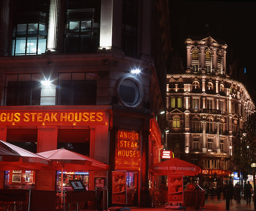

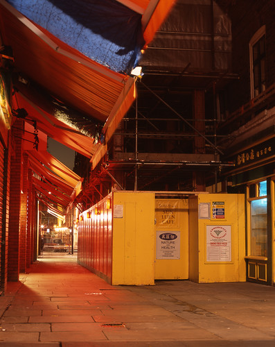

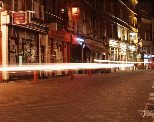

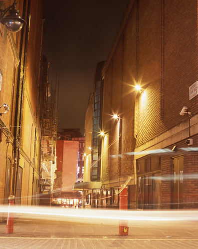

EdinburghGary wanted some dark slide scans, and I haven't been doing nearly as much scanning as I should have.
Here's a series of shots I took using the RZ67, 110mm f/2.8 and Provia 100F a few months ago. I seem to remember most of the exposures being 30 seconds+. They're probably shot around f/16 or f/22.
They're all straight out of the V700, partially for Gary's benefit. They've had mild sharpening, but nothing else.
Edit to add:
I'm making this an individual thread because I want to discuss scanning dark slides here, not because I want to draw particular attention to the photographs themselves. I may be following this up with some slides from a studio session shot on a black background.
Click to make biggerer!
1.
2.
3.
4.
5.

For these, it was Epson Scan, 4800 dpi, 48 bit colour, no multi scan/HDR/ICE magic, big green button GO!
Well you have instilled a lot of confidence in me! I was worried about shadow retention of details, and these photos are perfect test subjects.
