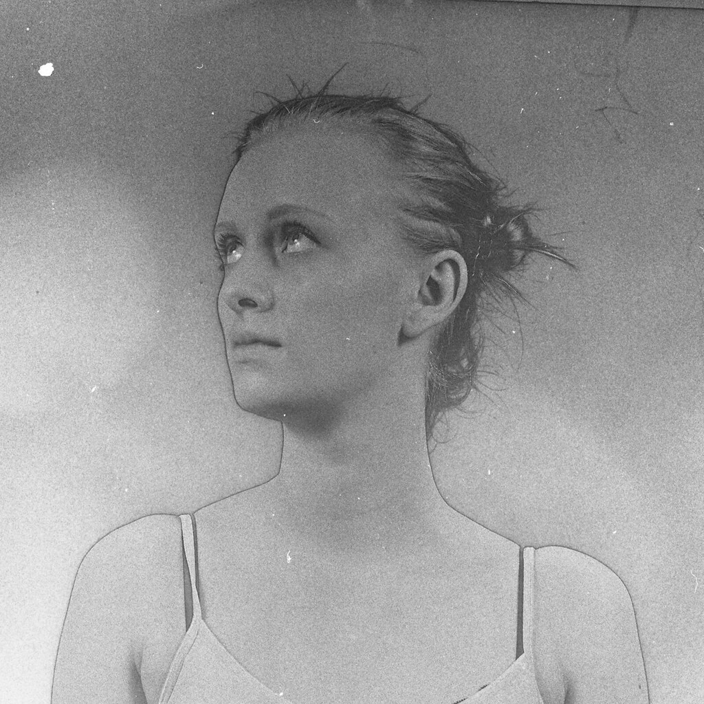

So having failed to determine the method used, it seemed that trial and error would be the only way to find out. I took two rolls of an identical photo of my daughter with strong bright light for a high contrast against a black background. I then cut each roll into 6 parts to ensure each part had one whole image I could use. The idea was then to develop each mini piece of fim separately and changing the variables each time to compare results at the end. The variables include total time of development, how far through development before exposing the negative to light, what type of light used, how close to place the negative to the light, length of time exposed to light, length of time to continue development after exposure.
For my first test the film needed 12 minutes total development. After 6 minutes I poured the developer into a jug and used a stop to arrest further development. Then in total darkness I removed the film from the tank, patted it dry. It was then placed 2 feet away from a white light for 2 seconds. The film was then put back on spiral and back in tank and developer added to continue development for the remaining 6 minutes. Then stopped and fixed as normal
And here is the result:
Kit 2 secs 50%
by SteveGam, on Flickr
I know it's not quite right, but I'm delighted with it as first go in the trial and error process. The black Mackie lines are there and the skin needs to be lighter so I think I will keep all the variables the same for next try but reduce the exposure from 2 to 1 seconds (or maybe longer but use a redlight rather than a white light).

Really well done. I'd agree about not drying the neg - a film of moisture will have far less effect than the harm you risk doing the emulsion.

im just wondering if the developer ( 2nd dose ) would actualy do any further developing after its been stopped .once you've got stop in there it would contaminate the dev , i would have maybe just took the top off the pot and flashed it without pouring the dev out ,,
having said that , i think you've done a brilliant job on what is an experimental picture ,,,,i think it woiuld make a superb print ,,,,

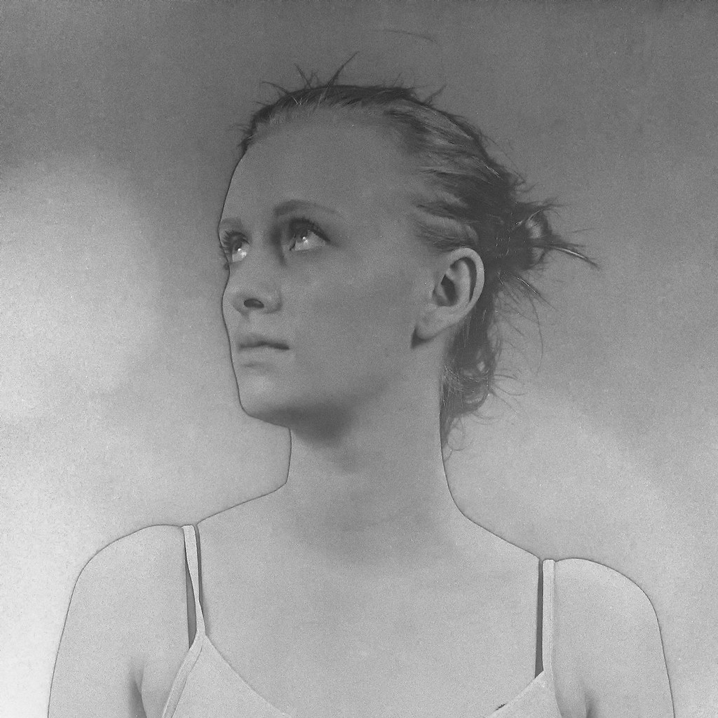

So after a lot of experimentation, here are the final results.
Method 1.
Expose negative to white light 30% of way through development for 2 secs. I think this is my favourite outcome, but it's the hardest to get right too:
Man Ray experiment - solarised negative

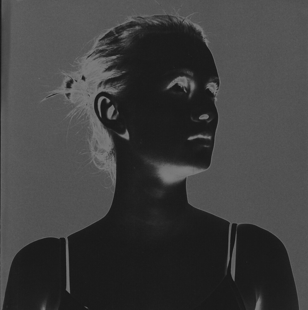

Method 2.
Develop negative as normal, but solarise print in the darkroom to get this:
Solarised print for Man Ray experiment
This solarised print then used as a paper negative to produce the Man Ray effect. This is a close second in my opinion to method 1 in terms of the result, but is so much easier that if I ever wanted to repeat the effect I would use this method:

Man Ray experiment - solarised print as paper negative by SteveGam, on Flickr

Method 1 is strees ahead of the others... streets! Great work, Steve...
Method 1, it might be the hardest but it yields the best result by far, well done Steve.
Yes I have to agree, its method 1.
Agree with the above, #1 is the most pleasing to me as well. The second (paper neg) one doesn't show the Mackie lines as much and the digital version looks very thin, although with a few extra clicks it would probably approach the look of #1. Very interesting even if my darkroom days are years behind me (small house and soups give me headaches!)
