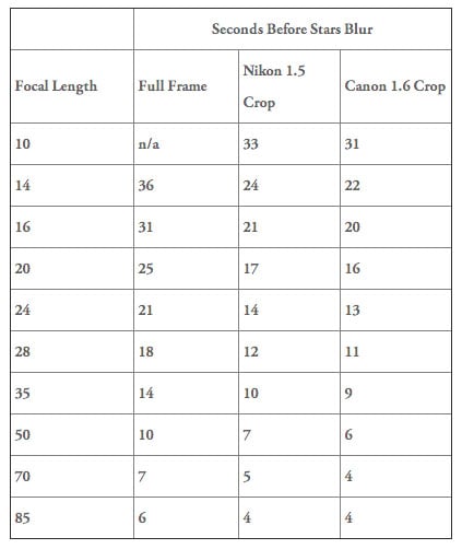

You need to turn the auto focus off and manually focus onto something in the foreground, then set the camera to manual. If you are wanting to avoid star trails, your shutter speed is determined by focal length, I'll put a chart up below. Aperture is wide open, f3.5 with the lens you have. Now all that's left to set is ISO, this is light sensitivity.

Here's a chart for shutter speed compared to focal length, I would go with 18mm and a shutter speed of 16 seconds, that gives you a second or 2 to be on the safe side to avoid star trails.
So just to re-cap,
Shutter speed 16 seconds
Aperture f3.5
ISO 2500 and higher if need be
Any more questions just ask, I'll try answer the best I can :)
Edit to add, the 500 rule applies to full frame, on a crop body it becomes approx. the 350 rule ;)
