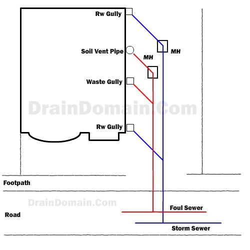

typical domestic drain system
more info here http://draindomain.com/system layout.html

Alastair the pic I posted was for example only and the guys house is 3 year sold so will definitely be separate
road storm drains are separate to foul drains
your domestic drainage system is very dependant on property age location and the builder of the property
