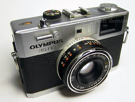

I own and have used many of these 60/70s RF.
For value for money, Yashica elctros ae absolutely fantastic. 20-40£ on the bay and used camera dealers. Lovely lens,but uses a very specialist batery ( which costs about 8 £ a piece). Its aperture priority ( i.e user sets the aperture, and the camera sets the shutter depending on the light condition). Yashica Lynx has a 1.4 lens, very fast lens for a 40 £ camera. however, these camera are a bit bulky, not really pocketable.
For the poketable variety, the easiest to get is Olympus RC ( and RD). Great little camera, great lens. Price 60-80£.
Konica S2 is also great les and so is Minolta 7sII. Size pprox that of a Leica CL, but price only 60 - 90£. These are metered shutter priority with a manual override. Incidentally most manual overrides in the 70s camera do not have meters; with the exception of Konica S2/S3.
