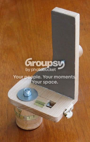

I remember it was very difficult to get a good stitch with PTAssembler to begin with. So I built myself a bracket. If you want to see click on the cross.
[/IMG]
pan2--web.jpg%7Eoriginal
However though accurate I still got bad stitches. Stitching software knows exactly how to frustrate beginners, and the learning curve can lead you to think that the software is rubbish, and that you need an expensive Pan bracket to do a decent stitch. Neither of these things are true.
