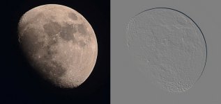

Here is one example of how focusing on the edge clearly resolves more detail along/near the edge than it does on nearer parts; even along the edge that is more frontally lit... I used "emboss" to make the depth of focus more apparent.
I tried to find an open source example that was well focused; but I don't know the specifics (camera, lens, aperture, stack, etc). Maybe I'll take some pics myself to demonstrate the difference.
