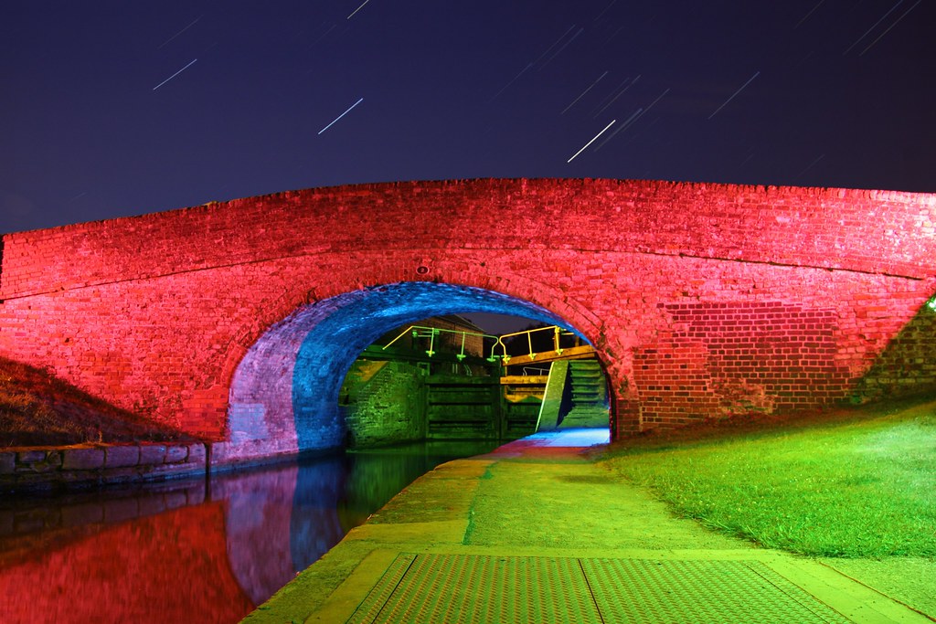

You talk about lighting the foreground with a flash unit... what is the best way to do this? Did you just do a burst of flash during one of the long exposures? How many bursts did you have to do to light the whole scene at the bottom of your posts and did you do all the bursts in one exposure?
To be honest it sort of depends on the scene (y) but if you take this one below it was about 15 flash bursts on 1/8th power for each colour (y)
212/365 by mwhcvt, on Flickr
Just press the "Pilot" button on the flash gun to make it fire (y) it's a little difficult to say x or y number of flashes as it really depends on the scene (y)
