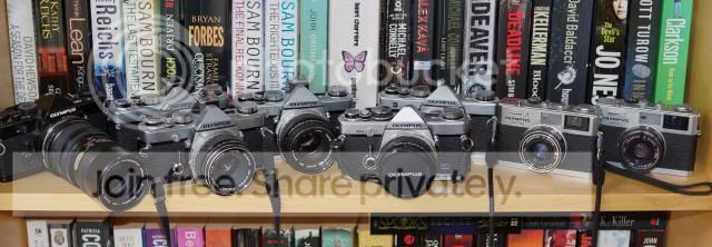

Cheers for the welcome. For the record here is a quick snap of my Olympus collection. Couldn't fit the lenses in.
Apologies for the poor quality but I haven't got the hang of this Photobucket stuff yet.

How do you find the trip? I put a test roll through mine and it appears to work but the photos were awful. Purely user error though, I bet!
I've got a Trip but those two are the 35RC. Like you I didn't find the Trip that great. An OM1 with a 28mm lens is small enough as it is.
