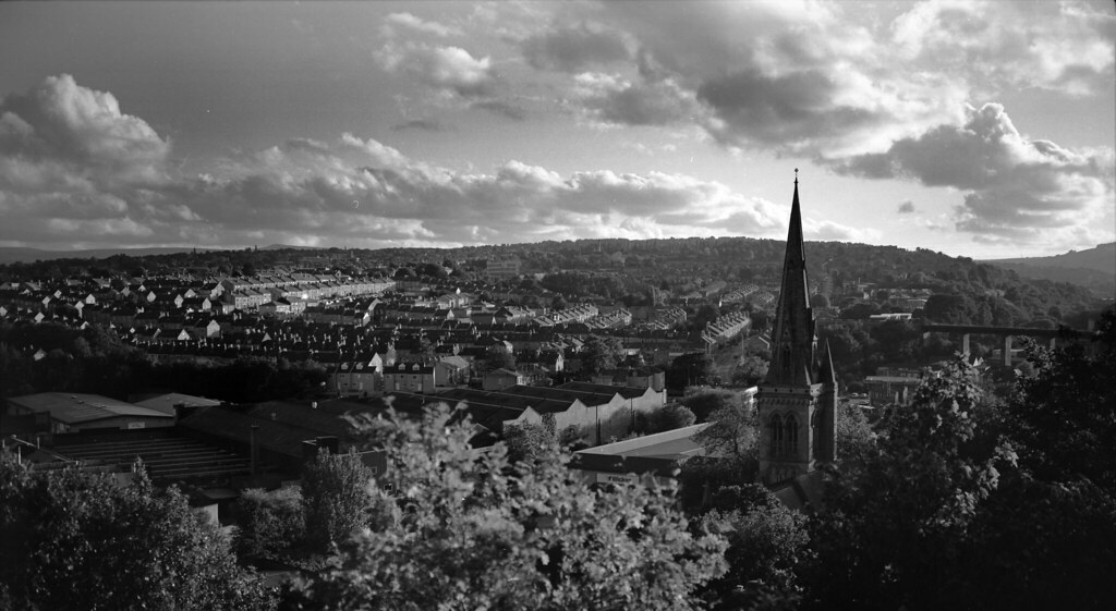

Lancaster Priory
Not sure why I'm getting lighter streaks down the church tower in the last one, but suspect they're from the squeegee or the scanner.
Beneath the clock face in the last photo, there are streaks that run parallel to the sides of the film roll. :(
You might have to click to make the image bigger before you can see them.
Thorton: the negatives aren't cropped, but the orientation was mainly because it was the first time I'd used the camera, so as well as checking for light leaks and vignetting from a hood, I was mostly just lining things up with the edges of the viewfinder to check how much more or less I'd get on the negative. The top of the church was lined up with the corner of the view screen, and I can see how much extra I got :)
Also with the top one I had no more room to walk backwards.
I see them now but they are so faint its difficult to attempt an explanation, I gave up on the squeegee after one roll, I find its as easy to run a finger down the neg, having said that my squeegee scratches were nothing like as subtle as those, so I'm guessing it isn't a scratch..
I can see them running down the length of the negatives, they are easier to see than in the scans. I guess it must be the squeegee, rather than something inside the camera, because they are not completely straight and parallel with the film.
I think I will use my fingers from now on, thanks for the tip! (y)

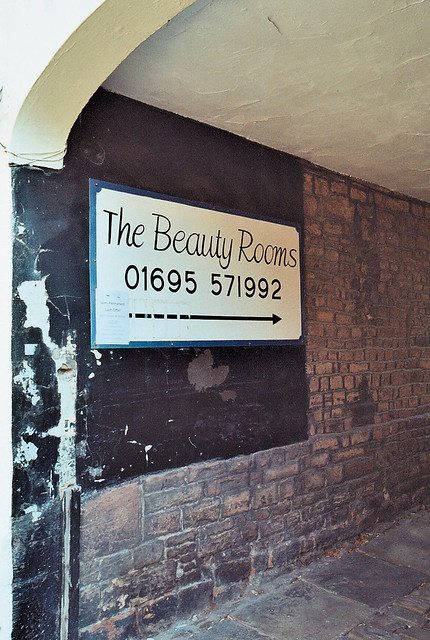

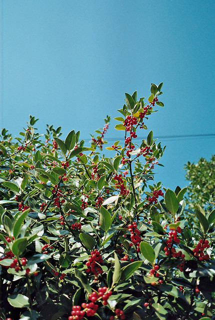

OK, after trying the B&W film for the first time a couple of weeks ago I decided to give some colour film a go. Nothing special just cheapo colour plus 200. Again manually focused but this time with the 85mm.
This film had some sort of scratch or groove all the way though it!!! You can see it in the images which im not happy about. Normally imperfections add a touch of character to film shots but this is just plain distracting. Plus this film seems to be grainier than the 400 B&W film?? I do like the disinctive colours though.. ; )
What do you think?

it looks like it could be a scanner problem as it is at exactly the same height through the film, it may be a scratch from the film advance but i think a scratch would be a lot darker as it has cut through the emulsion and would be more random in shape
The reason for the grain is because of the film - Colour Plus 200 is a very old Kodacolor emulsion from the 80's which is now being sold as a cheap film, supposedly from frozen stock that Kodak had leftover. Film technology has moved on greatly since then and grain is much reduced across all film speeds compared to then, especially with Portra.
The line could be due to a piece of grit or something being embedded in the foam lining on the exit of the film cassette so it creates a scratch as all the film moves out/in or from some dirt in the film compartment, blow out the compartment with something to reduce the possibility of this. Where did you get the processing done? In poorly maintained processing lines dirt etc can cause problems with scratching etc although its unlikely to be in one continuous line like that.
Seem good though.
