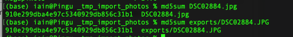

Interesting, I've just done a test, import jpg SOOC, export as "original" and the file is indeed different, the md5sum hash is different, so I checked the exif and it's modified (which would explain that).
BUT that's literally the only change. If I take the input file and export and strip all the exif (exiftool -all= FILENAME) then the original and export ARE identical:
So I can say for certain, Lightroom isn't modifying the pixels.

So what I'm showing is if I compare the binary 1s and 0s of the SOOC jpeg and the same imported to LR then exported, they're exactly the same. Lightroom makes no changes to the image. I'm comparing the binary rather than looking at the image as then it's not at all subjective, it's objective fact it didn't change it.
Unless I'm misunderstanding what you're seeing - as I understand it you're taking a jpeg from the camera, comparing it to the same jpeg imported, exported and re-imported to Lightroom? (I do see the differences you describe in your image, I'm not doubting what you're seeing. It looks, to me, like SOOC jpg vs LR processed RAW of the same image when you shoot RAW+JPEG).
Yeah I understand what you're saying, however even if the binary is showing no changes there clearly are changes if reds and greens appear different. I appreciate that you're saying t's subjective vs objective, however the differences are clear as day and as it's not just me that's seeing it then there are obviously changes occuring for whatever reason. It's clear in your example too, the reds on the left are more orangey compared to the ones on the right which are more cherry. It's very odd, even more so if you're saying the data remains unchanged :thinking:

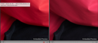

Yes, they’re different as that’s raw vs jpg. No reason to expect them to be the same.
Are your test files shot in raw+jpg? In which case you will be seeing the jpg on the re-import and the raw on the original unless you’re very careful to select JPEG as by default LR stacks them and shows you the raw.
Anyway it’s probably not that - you are processing in your export as you’re re-encoding the JPEG’s (and sharpening it etc). Decoding and encoding JPEG’s is a lossy process so there will always be changes. To colour and shape due to how JPEG’s stores and compresses both.

No I'm definitely seeing the jpeg in lightroom as I have LR set up so that it shows raw and jpeg files separately. How am I re-encoding the jpegs please? I don't think it's this though, as I said even before exporting the jpeg looks different in LR to the SOOC JPEG as you can see here. As I said previously, there seems to be more difference between the JPEG in LR and SOOC JPEG when the camera is set to AdobeRGB as oppposed to sRGB.

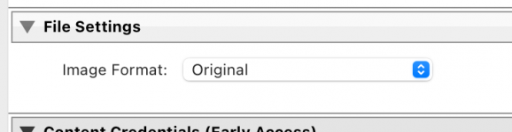

Here in the "file settings" choose "original image" and you'll get the jpg with no changes exported.
