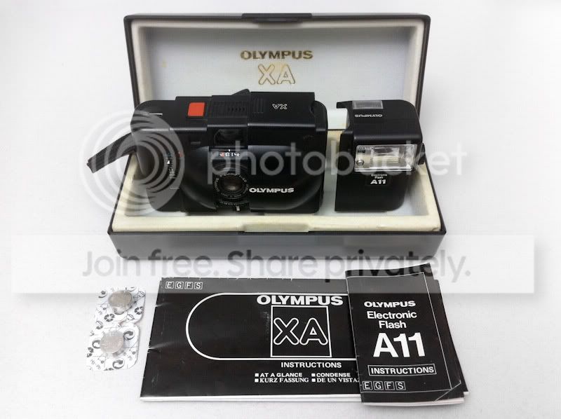

the postman delivered this reasonably-priced purchase this this morning. I'm intending it to be my 'go-everywhere' film camera.
Operation seems OK at first glance.
Loaded up with XP2 and I'm off to try it out.

I had one of those years ago - a great little camera and genuinely pocketable.
Just a word of warning ...I stuck a nicad battery in the flash despite the warning in the manual that it only too alkalines. It promptly emitted a cloud of smoke, crackled and died! The shop exchanged it with no argument even though I was honest about what happened.
This would have been a very early version - I dunno if it remained the same throughout production?
The manual doesn't say not to use Ni-Cads, but it does suggest Alkalines are preferred.
Thanks for the heads-up.
