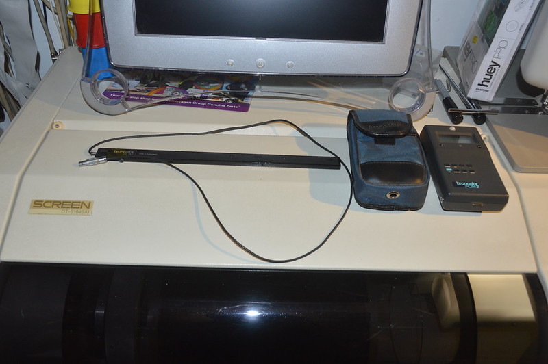

Broncolor FCM2 with case and probe about 30 from ebay accurately listed as one lead off the battery connector which was a five miniute fix.
:muted: wouldn't recomend it to anyone, my excuse is I have all the other Sinar TTL options: Sinar Six Proffi TTL Sinar Six Digitail , Expolux and Booster 1 so thought I might as well complete the set. The reason I would not recomend it poorer low light performance compared to the others the possible advantage is it can control / trigger Broncolor packs of the right Era.

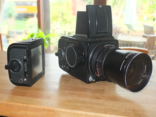

Lovely looking Hassy Des. I'd be terrified to buy one as I'd almost certainly change the lens in the wrong state, just when I needed it most!
There's very little distance between mounting and clicking into the centre - it's probably the most risky of the lens mounts I have used, if that's a reasonable comment!

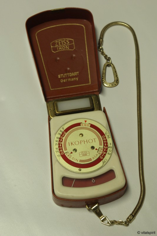

also like using a little Ikophot Zeiss thing i picked up. Worked fine for me on my roll of HP5
I have two of those and I found them accurate enough for slide film.
Check the film speed dials on yours. If you set it to 100 ASA, it should read 21 DIN but it is 1 stop (three DIN numbers) out.
I always use the ASA side.
Steve.
cheers steve (y) I always use the ASA side anyway, glad to know it's good enough for slide too as i'll be using it to meter some provia 400 in the next few days, although i'm led to believe it's a lot more forgiving than some of the slower films :)
Steve.
Your post and the photo of the Zeiss Ikon meter are interesting in that they serve to confirm that Z.I. had a different idea of the relationship between ASA and DIN from its modern correspondence. My Contaflex II's film speed dial shows 21 DIN as equal to 40 ASA. I wonder if this was a Zeiss Ikon thing, or prevailed across the industry in the mid 50s?
To get any kind of accuracy at all from the Contaflex's meter, I go by the ASA setting too.
According to Wiki ..."The ASA standard underwent a major revision in 1960 with ASA PH2.5-1960, when the method to determine film speed was refined and previously applied safety factors against under-exposure were abandoned, effectively doubling the nominal speed of many black-and-white negative films".
This might explain the difference on your Contaflex.

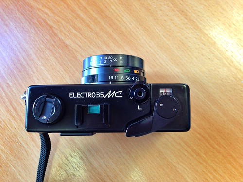

This has just arrived at my desk as I've decided to shoot 35mm for a while after selling my Kiev 80.
Untitled by Steve Lloyd, on Flickr Untitled by Steve Lloyd, on Flickr
Apart from a small bubble in the paintwork next to the viewfinder it's mint and I've just fitted 4xLR44 batteries taped together with a metal washer spacer and the camera is metering and adjusting the shutter speed perfectly so I'm made up.
I'm now waiting for the next delivery which is another Electro 35MC but in silver as I couldn't decide which style I preferred :0) However, I'm not going to be keeping both so one of them will go in the classifieds.
